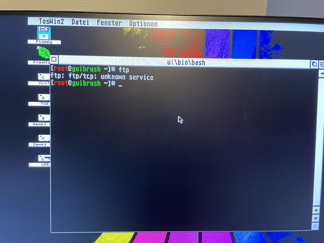

Download this one: https://freemint.github.io/sparemint/sp ... s/ftp.html (find some tool to unpack rpms, there's plenty) and download something from your local server to /u/ram. It doesn't use gluestik, it should be the fastest possible method.
Re: CT60e with MINT & Netusbee installation
okeyyyyyyy, now we dig into the real thing
I'm not sure if I do it right, I assume this muss me launched from the bash, therefore from tosWin2 ->Shell starten option.
I copied ftp in the u:bin directory, unpacked ftp.1.gz and placed ftp.1 in u:share/man/man1 and unpacked netrc.5.gz and placed netrc.5 in u:share/man/man5.
Then I tried to type "ftp" in the console, even changing the directory to /bin but....
But I'm not particulary confortable with Linux in general, it's probably me doing it totally wrong...
Actually, you did nothing wrong, I just forgot about one little detail and that is the need of having /etc configured properly.
I have it set up on my other Falcon so I can't give you a more concrete info but if you feel adventurous and want to extend your horizons ;) you can always install https://atari.grossmaggul.de/home.php?l ... e=easymint and its network package. That will give you many interesting command line tools (ftp included) and true unix environment. But you need an EXT2 (that's a filesystem) partition, installer can create one for you but it will delete all its data.
I strongly recommend to backup your whole C: beforehand. ;)

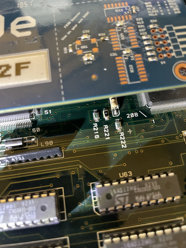

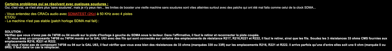

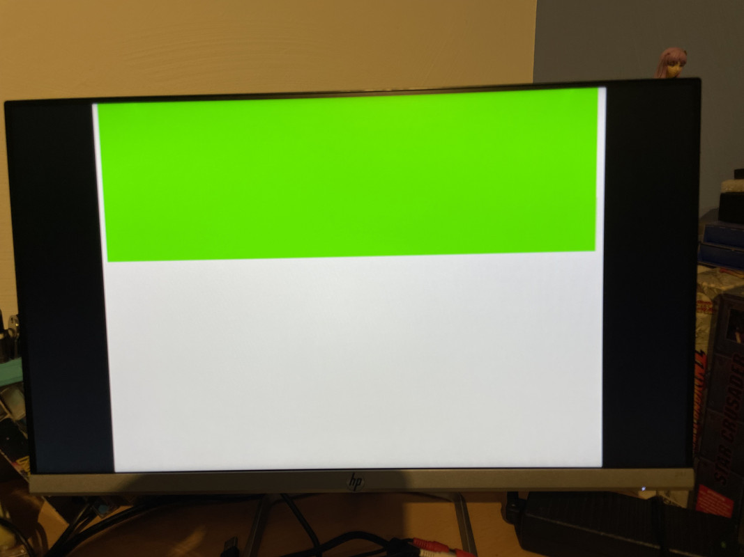

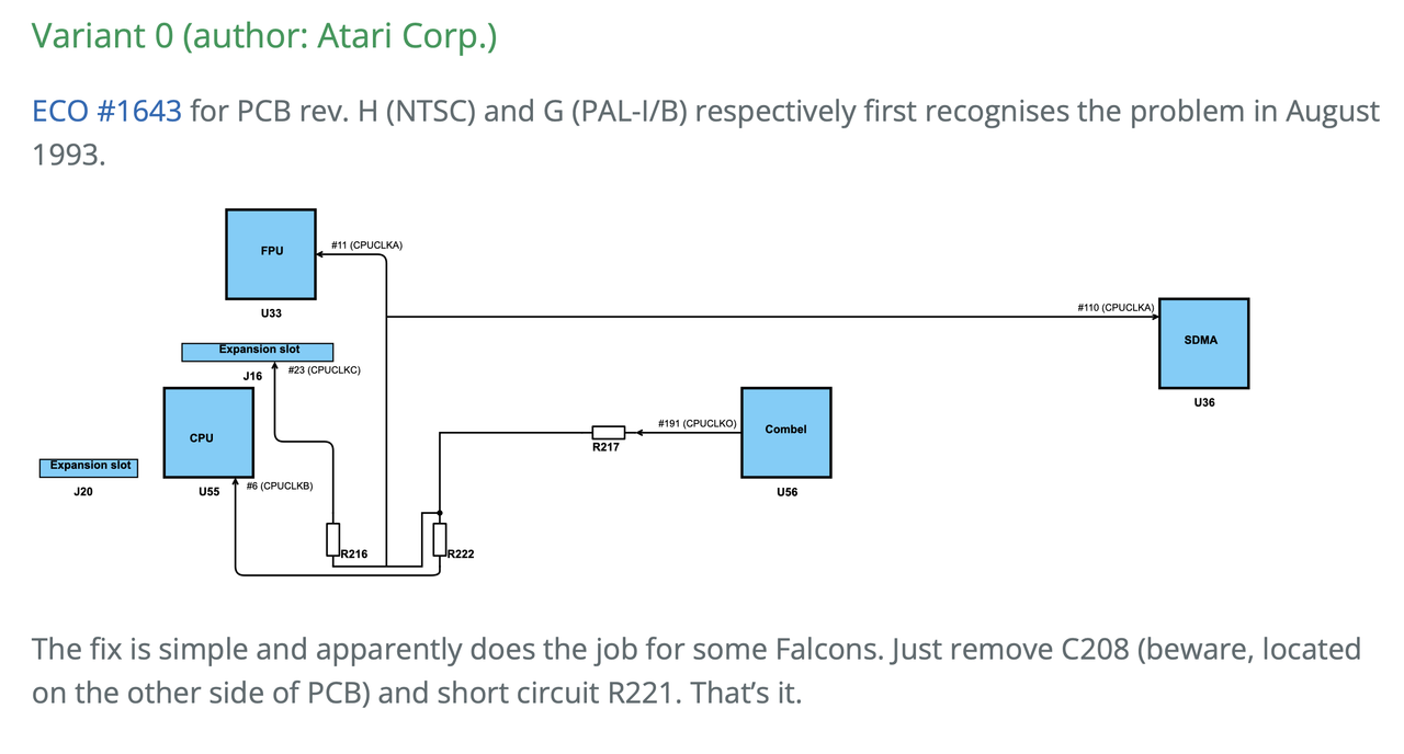

I just read on the Exxos web page that if a Falcon don't have the clock patch installed, then in order to avoid cracking sound and instability one have to check that a 330R is soldered on R2216, R221 and R222.
I checked my motherboard and I have a 0 resistor value soldered on R221.
Can it be the cause of my problem?
Beside the problem with Highwire, the Falcon is stable and can run hours with more than 12 programs opened and with MP2 playback in continue.
Sorry, I only found the French version, but I think you get the idea

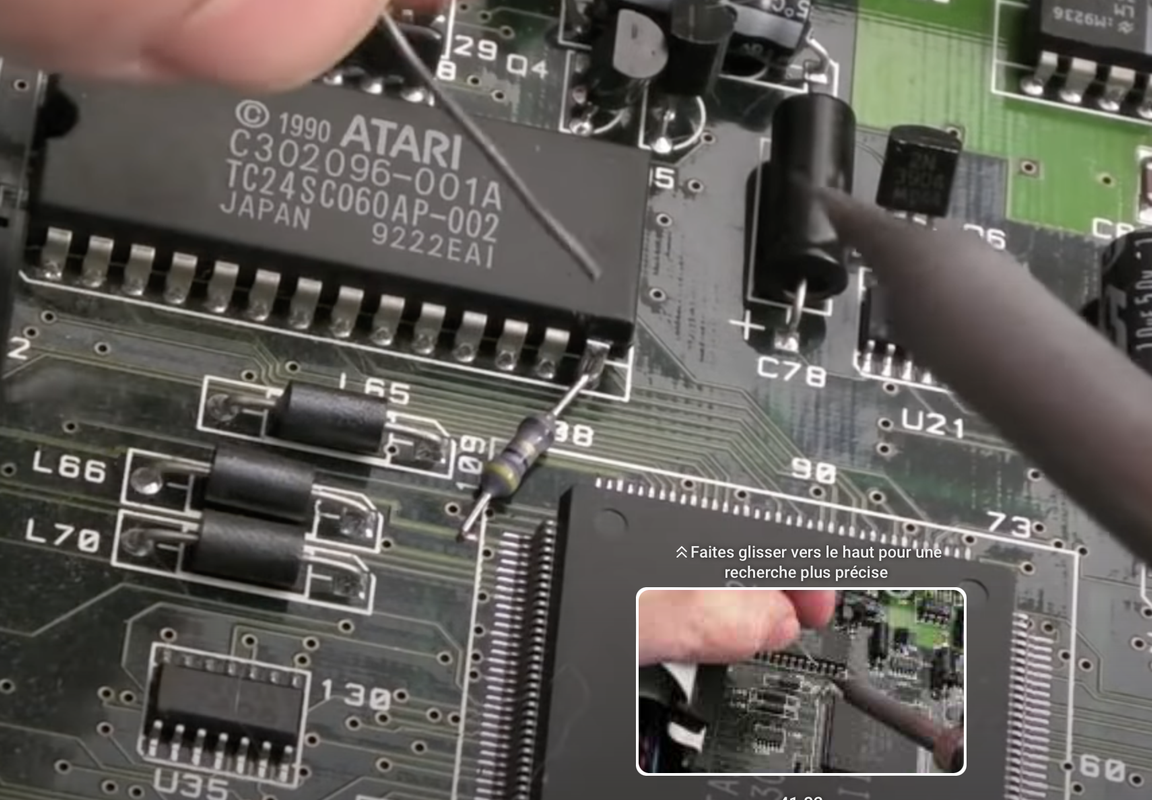

I found something about adding a resistor on C302096 to a trace on the PCB in this video:
https://youtu.be/-4RtB7mLBPI?si=OzYp5BJFelPbezfT&t=2492

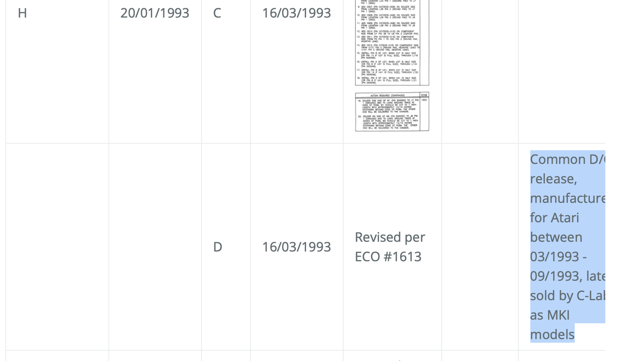

and I found a program apparently used by Atari to check if the Falcon called DMA2DSP-PRG. I run it and have only green on the screen:
In this case, is the replacement of the 0 Ohm with a 33 Ohm caps and/or the addition of the resistor on the PCB needed?
0ohm is correct. Don't go messing with clock patches to get Highwire working. Clock patches are only needed for DMA sound issues. And don't install that termination resistor either, it's the worst clock patch available.

and your other page about the different motherboard revision
https://mikrosk.github.io/clockpatch/history.html
I could find out that I have the motherboard CA401332-003 (but strangely with a French keyboard) and more specifically a rev H D/C, what is according your infos the latest Atari revision and was sold as the first C-Lab MK1 falcon.
So, this mean that the clock patch revision 0 is applied
So, can I assume that the clock patch 0 is in this case enough and nothing else is required?
I will do a totally fresh install as you recommend, now I feel more confident to make it.
About the clock patch, @stormy, thanks for your reply
@mikro: meanwhile, I found your excellent page about this mod
I don't have any browser installed on Atari, sorry.
As for the revisions, don't rely on them to the letter. You never know what the previous owner did with the machine, what an Atari dealer did with the machine etc.
Just open the machine and check for yourself if you are curious what clock patch do you have. However if you are not experiencing any issues (sound crackles during sample playback, SCSI errors), let it be.
ok. Yes, I checked my motherboard, there is no external fix (I mean, no wires and additional chip mounted), R21 is 0Ohm, so shorted, and C208 isn't present. So to me, it's look like Atari applied this first patch on the latest motherboard.
I don't have anything on the SCSI, and sound playback sounds ok to me. So I will call it a day and let it like it is.
