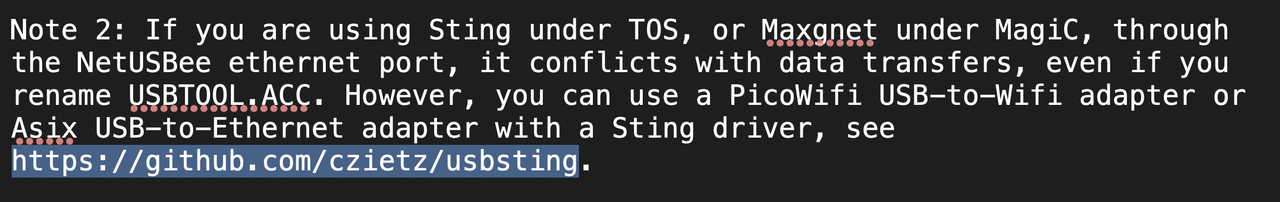

I just realised that the Netusbee used with Sting or Magxnet can't use the USB when the LAN connection is active. With Mintnet everything work. I realised that when I managed to install Magxnet yesterday on my MagiC installation, when I could'n access the USB stick anymore where it was possible before the installation of Magxnet. And then I saw that in the readme, confirming my finding:
I muss say that I'm a bit disappointed, what's the point of creating an inferface with both USB and LAN if both can't be used at the same time on two third of the OS...
I searched a workaround, one is given in the readme with the use of a usb to wlan adapter. I'm asking me what speed can be reached with this solution? Did anyone tried?
Another solution is the Daynaport emulation with the Bluescsi, but reading the files tell me that the floppy drive is deactivated when the network is running, and I think that there are no driver for Magic.
The last solution I see is maybe to use another TCP/IP stack for Magic, I see that something like Stik2 and iconnect exist, but I don't know if the netsubee is supported by those.
Maybe anyone has a hint or an input, of better, maybe anyone has a real good network card on sale (I know, I can dream) ?

guibrush wrote: Sat Jan 27, 2024 12:20 pm I searched a workaround, one is given in the readme with the use of a usb to wlan adapter. I'm asking me what speed can be reached with this solution? Did anyone tried?
I tried. :D
It is impossible to give you a universal answer to "what speed can be reached". It depends on the machine, the USB adapter, the network stack, the client software, among other things. But to give you an example: The PicoWifi with a TT, a Lightning VME, under TOS with STinG, and with PFTP gives me download speeds of roughly 200 kByte/s.

I saw in the GitHub that it require a Asix AX88772 chipset. I found this one:
https://direkt.jacob.de/produkte/I-Tec- ... 26812.html
that got a Asix AX88772B, I hope it's good. I didn't find an adapter with the AX88772 only without extension.

So, I got both USB adapter and Pi pico W today, but I need a little bit help. First, I could confirm that both USB adapter and Pico Pi work good with UIPtool under TOS. First I didn't understood why it doesn't work, but then I realised that I still have to launch the USB stack before UIPtools is launched. With both dedicated UIPtool version I can have a connection with both LAN adapter and Pico W.
But I'm stuck with the configuration under MINT. I'm using the config tool that come with VanillaMINT and did the whole configuration: asix.xix renamed to asix.xif in mint/1-19-bc6 drawer, ne2kect2.xif renamed to .xix to avoir 2 drivers loaded at the same time, eth.udd in place in the USB drawer in Mint, ip address assigned, asx0 interface selectionned (for the wired USB connector) in the tool, checking the file network.chf let me think that everything is ok. But I have no connection. Then I realised while watching the booting sequence that the USB stack is launched with the line
exec c:/c/mint/1-19-bc6/usb/loader.prg.
is launched after the TCP stack. I think that it muss be launched before, right?
But here is the culprit: everytime I try to move this line up in the config file, some hidden process take it back after the loading of the ipconfig tool. First I thought thatI forgot to save, but no, it's really each time putted back at the end of the file.
So, what did I miss here?

geeeeee, now I get it....
You can slap me virtually behind the head.
The answer is this:
I MYSELF created a rule that overwrite the mint.cnf to be able to boot into MyAES or into XaAES....
mikro
