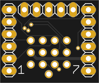

My new, compact Atari -> VGA adapter.

Is a complete Atari monitor plug needed or are the pins directly connected to the PCB? This could be simplified into a simple plug replcaement, pins into the Atari and outside a simple interface to something else, just the 13pins on a small PCB....
Re: My new, compact Atari -> VGA adapter.
Yes, one could just mount long headers on it, however some extra support would be needed under the VGA cable since there would be no support keeping the pins from bending. But a 3D printed case could provide this support.
This is my dev board:
I see you're up to version 5 now. Great work!
I'm looking for something similar, but for a recased STe with the features you have in your Multisync adapter but with a 13-pin Atari connector in addition to that, so that I can choose between attaching an Atari colour or monochrome monitor (and the computer will recognize them as before), but also a multisync VGA monitor. A 3-position switch would choose between:
1) "Atari monitor" auto mode
13 pin Atari monitor output (the STe recognizes the attached monitor as a mono or colour type and sets the resolution accordingly)
2) "VGA mono" mode
VGA-connector output (the 13-pin DIN is disabled so as to not cause any problem if an Atari monitor is connected simultaneously)
STe output is set to "high" as pin 4 (mono detect) is connected to GND which forces the computer into "high" mode
3) "VGA colour" mode
STe output is set to "medium/low" as pin 4 (mono detect) is NOT connected to GND which forces the computer into "medium/low" mode
Would it be much work to add these features?
Yes it would be. I'm quite content with the size of the board. And adding an extra port would widen the board with 10-15mm, 50%(!).. frankly it's not a function that I think the "masses" are looking for. Since one still can just switch the monitor cable with the adapter quite easily.
I see what you mean.ube wrote:Yes it would be. I'm quite content with the size of the board. And adding an extra port would widen the board with 10-15mm, 50%(!).. frankly it's not a function that I think the "masses" are looking for. Since one still can just switch the monitor cable with the adapter quite easily.
Would you mind if I try to modify the existing schematic to add the features I'm looking for?
Sure, go ahead. It's virtually free to use.
Thanks Ube
The multiplexer is a neat idea. I might have some ideas up my sleeve to make it work with both output connectors.
Would anyone else be interested in such a variation of the board as I've described a couple of posts back?
Oh. It does not use the CD4053 anymore, switched to an IC made for video: TS5V330. You'll need three (two if you find a 2p2t high bandwidth IC) of them to get all the switching capabilities you're looking for; you're switching Hsync and Vsync as well. Or, maybe you could have the signals go straight to the VGA and DIN13 connectors, it's not the cleanest solution but it might work.
I'd use an attiny85 to detect the correct monitor type if using an Atari monitor. And do the hi/low switching with a NPN transistor. You'll need this because you can't have pin4 permanently connected from the Atari monitor since that would block switching hi/low in VGA if a SM124 is connected to the DIN13. An added bonus is that you won't need any 2p2t switches, just two momentary switches that's being read by the attiny.
This unless you come up with a more cleaver solution.
The TS5V330 acts like a physical switch, routing the display signals, right?
Your idea is well thought through and executed, and I have to admit the attiny85 detection and transistor switching is a little over my head so I'll have to study the schematic and those datasheets a bit more to fully understand it. This may be a little more complex than first anticipated
Regarding the momentary switches -were you thinking one switch for "colour" and the other for "mono"? Upon power-on of the computer, would the last setting be remembered, or is it reset to one specific mode each time?
My initial idea was to use a 3-way 2 pole slide switch on the back of the (rack mounted) computer casing, near the video output connectors for the mode setting since this isn't something I'm going to be changing all the time (most of my software is for hires mono use).
Yes, it acts as an 4p2t switch.
The momentary switches are for VGA/DIN13 output and hi/low res for VGA. And if using an attiny one could save the last state. I've tested this design quite recently (attiny and momentary switch) and it's only like 10 rows of code needed. I think the hex file was 360 bytes or so, so it'll fit on an attiny with room to spare.
You can't just use a 3p2t switch since you'll need to do two different switches, RGB/mono signal and VGA/DIN13 output. It all comes down to how neat you want your design to be. You could connect all RGB/mono pins directly from the Atari's output to the DIN13 output and thus have mirrored image from the VGA output (if the correct type of monitor is connected).
But you'll have to take care of pin4 somehow, leaving IN on the V330 floating will produce lots of flicker on the VGA monitor, it has to be either high or low.
FUUUUUUUUUUUUUUUUUUUUUUUUUUUUUUUUUUUUUUUUU! Wrote a long post how it could be fixed and I got logged out.. Ok, here goes. Again.
Now that I'm awake I've been thinking of this.. And I think that this circuit ought to to what you need it to do when it comes to blocking the monodetect from the monitor. Atleast I think this should be possible to integrate directly with my design. In short: two PNP's, two 1k and three 10k resistors.
TPXX = TS5V330 pin
MPX = Monitor pin
APX = Atari pin
Whats missing in this circuit is R5, connected to base of Q2. Q2 is the wrong symbol, should be PNP not NPN. Oh, and I'm not sure if the Qx pull-ups should be before or after R1 and R5, but that's just a matter of checking in a simulation.
SW1 top to bottom:
Top: TP1 pulled low, enabling S1 ports = hires
Middle: TP1 pulled high, enabling S2 ports = lowres.
Bottom: TP15 is pulled low, disabling TS5V330 all together. Q2 base is pulled low, connecting MP4 with Q1 base.
R1, R5 = 1k (ought to do it).
R2, R3, R4 = 10k pullups.
TPXX = TS5V330 pin
MPX = Monitor pin
APX = Atari pin
SW1 top to bottom:
