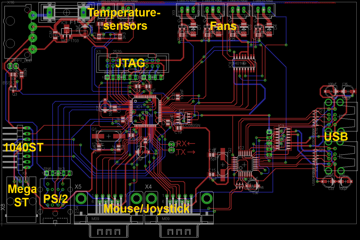

Started on it a long time ago, but quickly realized that PS/2 devices are getting hard to find. But it's not very difficult, I'm quite familiar with the IKBD protocol by now so if people are interested I could finish it. But I have this idea to create an "Eiffel" that handles real USB devices instead.
Now that would be really interesting! A USB keyboard/mouse interface for the Atari ST! Decent PS/2 keyboards and mice are harder to come by these days and according to my findings, even using USB to PS/2 hardware adapter plugs only works with very few keyboards, and just about none of the recent keyboards. I've heard about active USB to PS/2 adapters, but according to what I've read there's no guarantee they will work with a particular USB keyboard either, so it seems the best solution would be for a real USB interface.
Is this a project which could become reality in the not too distant future?

Arne
Posts: 723
Joined: Thu Nov 01, 2007 10:01 am
Re: Flashable TOS ROMs in ST.
Post by Arne »
I've been thinking about a combination of USB-HID devices and PS/2 to attach to the Atari's keyboard connector for some weeks. Had a look at the Eiffel project and decided to add temperature sensors (cheap LM335) and standard 3-pin 12V PC fan connectors. Theses may be added on a separate daughter-board - probably not everyone needs them.
I've created a schematic/layout for an evaluation board to test the software-algorithms i.e. this is definitely not the final board (if it ever gets manufactured).
The PS/2 part is pretty cheap, just connector and resistors. Most complicated HW/SW is (of course) USB. I've already had luck with reading chars from keyboard with a standard LPC1768 board but I am not familiar with IKBD mouse/joystick packets. The microcontroller is pretty big in terms of memory because the USB Host (!) stack
needs approx. 22KByte of RAM.
Unfortunately my preferred PCB manufacturer for prototypes is offline till summer :-(
troed
Posts: 1462
Joined: Mon Apr 30, 2012 6:20 pm
Post by troed »
Arne wrote:The PS/2 part is pretty cheap, just connector and resistors. Most complicated HW/SW is (of course) USB. I've already had luck with reading chars from keyboard with a standard LPC1768 board but I am not familiar with IKBD mouse/joystick packets. The microcontroller is pretty big in terms of memory because the USB Host (!) stack needs approx. 22KByte of RAM.
Is this reusing anything from Alan's Unicorn and its software? Of course, there the host software is on the ST which means the USB mouse support isn't transparent to native software.
/Troed
