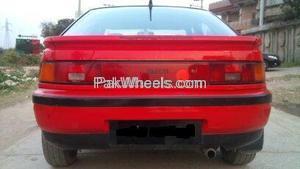

Until then...I've got this 1991 Plymouth Laser that I'm attempting to restore (its
been parked, not started for the last -9- years):
Wish me luck! :roll:

Is this what you are aiming for DarkLord!

Something like that. :)
Be nice to wind up with it looking that good, but we're a long ways
from there!

Man... though it was just a photoshop away..... :mrgreen: sorry.

This car looks very like a Mazda 323 from that time period but a little larger.
