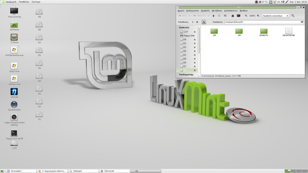

Hey! I have atari 520stfm with tos 1,04 and 4mb ram. I am using now Hddriver 9.0 but yes it cost much! 45 euros at the beginning and 12 euros update eg from 8 to 9, all others are free. So i have payed 45+12+12 from 7 to 8 and 8 to 9,0 now. I have ppera driver too, i want to try it today. My linux pc cant see hddriver driver sd card:(( wants windows and i can see only the first partition. I have a 1gb sd card partitioning to 2x512mb so tos 1,04 can see them, but with tos 1-1.02 must use 4x256 mb partitions.1gb sd can use all with tos 4+ Ppera driver is newer than hddriver, so i have bought it already, but with Pppera games images, my linux can see the partitions!
just now tried a 4GB microSD to SD memory card with Ppera driver and yes linux can read partitions!! at last
