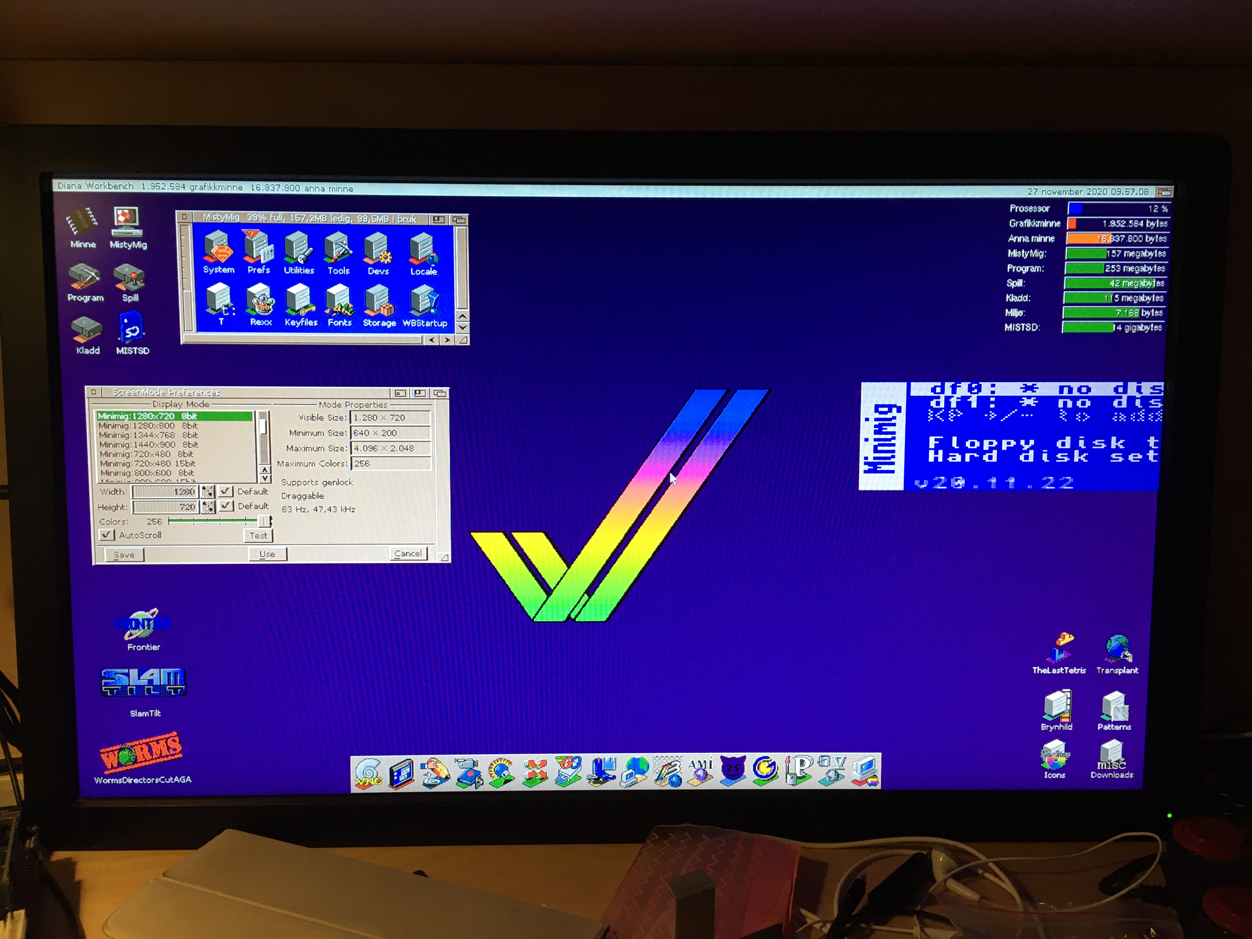

Post by kolla »
@robinsonb5
Anything that can be done do improve the position of OSD when using RTG? :)
(And 16bit modes would be great, though it has been mentioned by certain OS and P96 developer that support for 15bit modes may improve as well.)
-- kolla

kolla wrote: Fri Nov 27, 2020 9:07 am @robinsonb5
Yes, probably. (I'll try to find a way to do it that doesn't bring it way over to the left for regular modes!)
Yes, I do plan to do that - it should be relatively trivial. It would be nice to support the new screen-dragging feature, too, but that's slightly less trivial.
kolla
Posts: 341
Joined: Thu Sep 17, 2015 11:39 pm
Re: Work on the Minimig core?
Post by kolla »
Cool! :)
Btw, I notice you use your own vendor ID on the "4MB Zorro 3" expansion... and that one is not registered in the semi-official boards.library (which sadly relies on one single person for updates) - previous minimig zorro expansions have been using 5020 (Rok "chaos" Krajnc) vendor ID (and apparently Sorgelig just re-used those for his z3 expansion boards on the MiSTer) which is registered with boards.library - doesn't it make sense for everything Minimig to use a "Minimig" vendor ID, instead of such personal IDs for people that may come and go through the years? I notice that UAE seems to use same vendor ID (2011, not 1803 for some reason) for all their ram z3 expansions.
-- kolla

kolla
Posts: 341
Post by kolla »
robinsonb5 wrote: Fri Nov 27, 2020 1:44 pm An "official" Minimig vendor ID is a good idea, but equally I like the fact that users on MiSTer see Rok's name in the board info, given how much of his work their core contains.
Sure, but that is only possible because someone added Rok's info to boards.library, your ID is not there, mr 5017 :)
-- kolla
