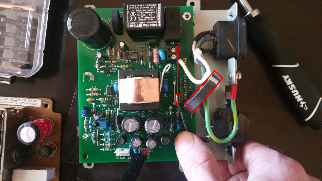

Hello!
It's been a long time since have been on here. I'm guessing it was about 9 years ago that my 1040 STE quit working overnight. I would flip the power switch and would get absolutely nothing as if it were not plugged in. I got some help on here and most signs pointed to the power supply being bad.
Fast forward many kids and many years later and I think its time to buckle down and bring this 1040 STE back to life.
This brings me to my question. What are my options for a new PSU for my US 110v 1040 STE?
I have looked around the last few days and it looks like my only options are an Exxos PSU or a Pico PSU.
I'm leaning toward the Exxos as it looks fairly simple. I just have to cut off my old power plug and switch and wire/solder it to the new PSU.
Is there anything I have overlooked? Are there any other options for a new power supply?
Thanks in advance!

Postby Silence The Fallen » Mon Oct 07, 2019 7:19 pm
Thanks to everyone's help. I ordered and received my new power supply!
I have a couple of questions that I am hoping you all can answer and thought it best to continue in this thread rather than starting a new one.
As you can see in the picture. The wire from the on/off switch will not reach where it needs to go. My plan was to de-solder the wire from the switch and solder a longer wire back on. The jacket says 18 awg, which i am assuming is 18 gauge wire, but I'm not having any luck finding what i need. Perhaps I'm not searching using the correct terms. Could someone link to what wire I would need to use (like on amazon or something) and then I could order it, or even better locate it locally.
Also... Do I need that giant magnet? Can I remove it to give the wires a bit more slack or it best to leave it on?
dhedberg
Posts: 1123
Joined: Mon Aug 30, 2010 8:36 am
Re: PSU options in 2019
Postby dhedberg » Mon Oct 07, 2019 7:27 pm
If you have some spare power cable somewhere, just cut it and remove the outer PVC from it and you'll find 3 wires in it. Use one of those.
The ferrite bead you can get rid of if it's in the way, it's there to suppress noise but is not critical.

Postby Silence The Fallen » Tue Oct 08, 2019 4:41 am
dhedberg wrote:If you have some spare power cable somewhere, just cut it and remove the outer PVC from it and you'll find 3 wires in it. Use one of those.
Thanks for the suggestion. I have plenty of old power cords, so I did just that. Just finished up with everything and after 9 long years it LIVES once again!!!
Seriously BIG thanks to everyone! You have no idea how happy this makes me! Then again, maybe you do. I suppose we are on an Atari forum, after all.
