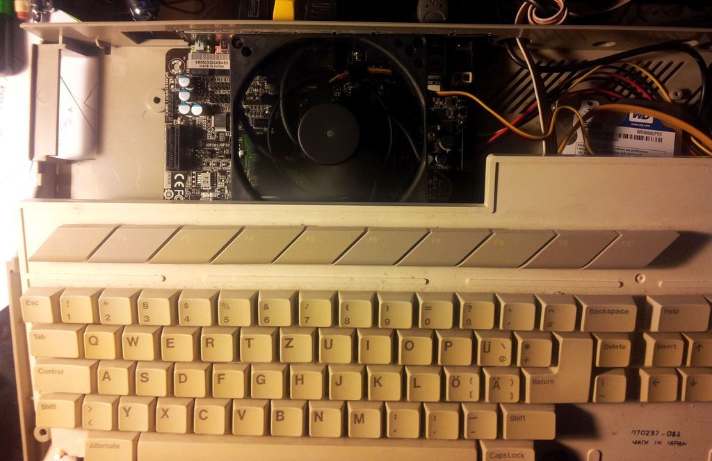

megahz wrote:@Claus:
you could cut a few of the heatsink parts, i did that with a D510MO Mainboard too, so it fits into a 1HE 19" Case.
Doesn't get much warmer........
I could but I won´t. ;) I´ll never touch the board in that way.
But I will give it a try to find other ideas to cool it down enough so that the heatsink won´t boil the kb. :D
Maybe something like this: iNTEL HTS1155LP
Claus

Re: Atari st series computers conversion PC
Postby spiny » Thu Oct 08, 2015 3:39 pm
I agree with megahz - you could trim the fins that are in the way, and probably not see any impact with temps. For backup, you could put a small fan in there as well, to blow air over the heatsink.

Postby LuckyOldMan » Thu Oct 08, 2015 4:55 pm
spiny wrote:....- you could trim the fins that are in the way, and probably not see any impact with temps.
The fins aren´t in the way - they just touch the kb´s backside. Most 520-kb are bent a bit in the middle after all these years so I guess that´s why.
spiny wrote:For backup, you could put a small fan in there as well, to blow air over the heatsink.
I planned that right from the beginning (Scythe 100mm - !.000 RPM) - not only as backup (see pic).
The fan couldn´t be placed right above the heatsink (kb-cover is just placed on top not screwed) but the air circulation is good enough that after 1 hour working with the PC right now the heatsink has less temp than my hand. :)

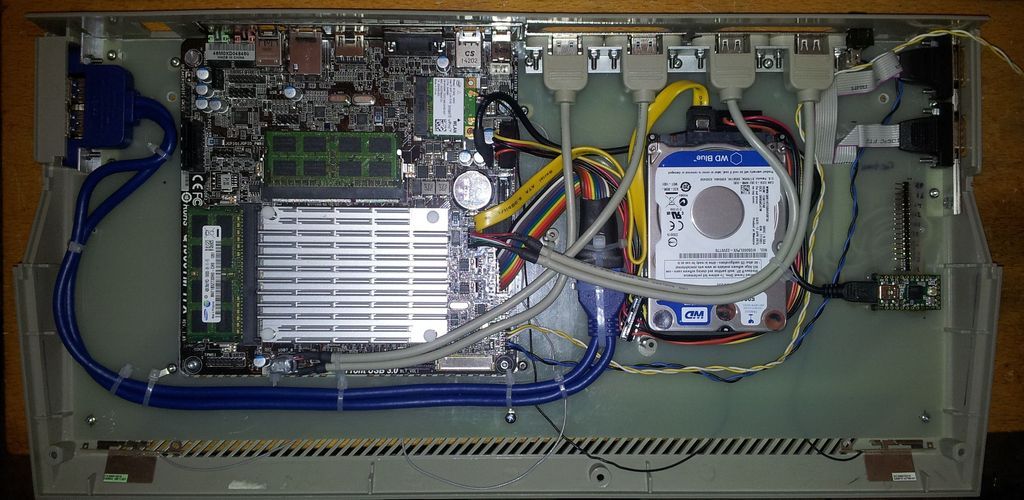

Hi there,
after waiting for a few parts (USB3.0-header-adaptor,...) coming from China I completed my 520ST+ -PC. :)
I also added a half-PCI-e-board for WLAN & two small HP-Laptop-antennas (front left & right).
Next week I will get a cleaned 520ST+-housing & keyboard almost looking new and then this mainboard-base with all the parts will be transferred.
But already now my Atari520ST+ -PC is working fine! :)
Done this a new project is already waiting: the Atari 1040ST-PC! ;) Just as done with the 520ST+ the mainboard in 1040 size as base is already finished & the Teensy2.0 fixed.
Hopefully soon the new Gigabyte H-170TN mainboard will be on the market and combined with a Intel Core i3-6300T it could be a nice Atari 1040ST-PC! :)

I've had another play with this tonight and figured I'd try it on a USB 2 port instead of USB 3 (testing on PC before going to the Pi).
It seems that it works fine for half a dozen or so characters then decides that it's going to throw in random characters on a keypress, sometimes two. A lot of the time it will throw in what seems to be F1 as Internet Exploder gets launched and goes to a Windows 10 help page, other times it brings up the search box in Notepad (which is where I'm trying it) or a dialog box with string not found.
After this I have to disconnect the Teensy for a while and plug it back in. I get the same results plugging back into USB 3 so it's not a USB2/3 issue
Any way to check if I have a good Teensy? A bit stumped at mo.

vfrvulcan wrote:I've had another play with this tonight and figured I'd try it on a USB 2 port instead of USB 3 (testing on PC before going to the Pi).
As before, any help appreciated!

roninfourseven wrote:I am also sorry to pull up this post after such a while, but I am in the same boat as VFRVulcan. I also have a Teensy 2.0++, and am wired identically.
Something is clearly working, as if I type as soon as I plug in the keyboard, I can type actual words, but within 30 seconds it all goes awry and I just get random characters coming through.
I have tried both the Tennsy 2.0 and Teensy 2.0++ firmware from this thread and the result is much the same, with immediate use showing the correct characters, and 30 seconds later, garbage.
I am more than willing to do any testing to get this to work.
I can confirm that the test programs for the Teensy work fine, and as it was brand new I am willing to believe that is is fine.
Well, six weeks after giving the Teensy 2.0++ to my cousin to solder properly for me, I finally got it back today. Been itching to get this sorted for ages.
I plugged it in - and it didn't work. Re-flashed the firmware and tried again - success! It has now been running for around 5 hours, initially tested on a PC but then attached to my Raspberry Pi 3, done a couple of RetroPie full updates, used the terminal, kept on typing and not dropped a beat until I plugged an ST mouse in while 'hot'. The characters 513 were displayed on the terminal but pressing ctrl-C cleared the line and all was good. I unplugged the mouse again but really should spend some time trying it, along with a standard Atari joystick instead of using the USB StellAdapter as before.
So Ronin, might be an idea to check your soldering, my original effort is shown in my post above, now it looks like the pictures attached here, and as I say, not skipped a beat in hours! Only difference physically is that I asked him to connect the ground to pin 8 instead of pin 1 on the keyboard end
And a massive thank you to Joska for his sterling work. :cheers:
