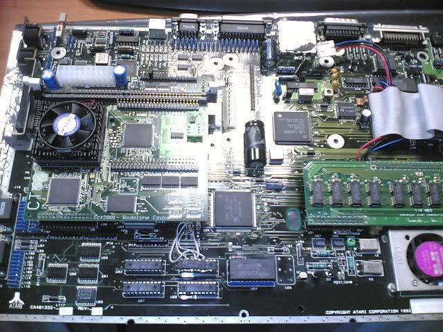

Postby keropi » Thu Apr 17, 2008 3:59 pm
Hiya! :cheers:
I just received my mobo from mr. Czuba , he patched it , replaced clock chip with a socketed one and installed the 060...
are there any tips I must know about software installation? any patches perhaps nescessary?
thanks! :D
