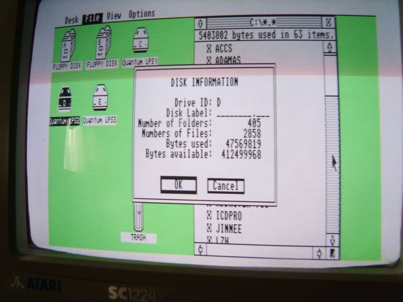

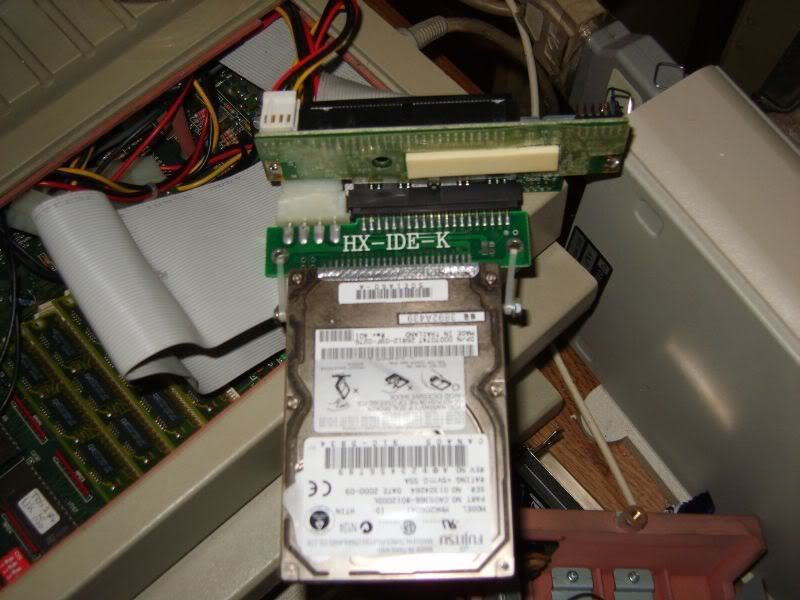

Postby PaulB » Sun Jul 15, 2007 11:12 am
Mega STE using standard Atari internal host. TOS 2.06. 4Mb.
Yamaha SCSI-IDE converter model V769970.
3.5" to 2.5" IDE adapter.
Fujitsu MHK2060AT 2.5" 6gb hard drive.
For the hard disk driver I'm using ICD Pro 6.5.5 . I remember why I used that now instead of HD Driver. It was because I could partition the whole 6gb of the drive and ICD Pro has the ability to effectively swap the partition that's currently in use so I can access every partition on the drive, just as long as the total space used at one time dosen't exceeed 1gb.
For the CDRW driver I'm using Extendos Gold 3.2 connected externally via a Link 1 host connected to an external box with another Yamaha convertor plugged into the back of an LG GCE-8160B IDE CDRW.
I tried the DVD burner on the Atari when I first bought it (just to read a dvd movie disk). After finding out that it works I promptly placed it into my PC. It's a Phillips Lightscribe dual layer model. Can't really be bothered to open the case to find out the model number but if it's really important to anyone I will :D
Sorry but it's a bit blurry!
Been using Magic and Jinee lately but this is a pic of the standard tos desktop without the cd connected (it's under about 6 other Atari's in the spare room!)
